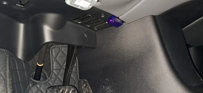

How easy is to get the dongle set in the car? Do you mind sharing a photo? I am tempted to get one :)
This is my blue ELM327 mini OBD2 bluetooth dongle, permanently installed into the car. It doesn't set of the alarm as on my MG4 when locking the car. Unsure about any potential parasitic 12V drain tho, but no problem yet. Maybe not the best idea to keep it there if car is stationary for a long time. It connects to my CarScanner app. This is a LHD car tho, so I suppose it looks different on RHD cars. Will start collecting data now.

This is my blue ELM327 mini OBD2 bluetooth dongle, permanently installed into the car. It doesn't set of the alarm as on my MG4 when locking the car. Unsure about any potential parasitic 12V drain tho, but no problem yet. Maybe not the best idea to keep it there is car is stationary for a long time. It connects to my CarScanner app. This is a LHD car tho, so I suppose it looks different on RHD cars. Will start collecting data now.
