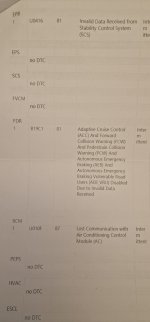

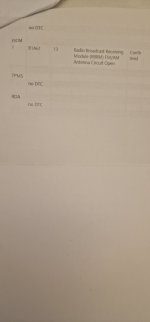

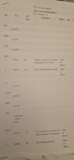

The garage who repaired it told me that the vehicle was safe to drive when they returned it to me on Tuesday. Because i knew I wasnt to blame for the accident i needed proof of there having been something wrong with the vehicle. I booked it in with MG as soon as possible and this is what they came up with. This really is a long story and I am pursing the garage, tesco insurance and the leasing company. Tesco said the vehicle had to go to this garage. MG said it was ok as long as theynused genuine mg parts for the car it would still be under warranty. I see a long road ahead trying to get the garage to say they returned the car when it was unroadworthy etc etc. The scary thing is, why did it fail on so manynthings? How would you ever know? Do you have to have an accident for these things to be picked up? If I accepted it was my fault and took the car back, i would still be at risk of it happening again and could have possibly killed someone!! Thats not being dramatic thats telling the truth.
"Ghosts in the machine" I wonder? With 8 faults, that would suggest a number of modules being involved. With all these systems running their own code, as Asimov envisioned, eventually there would be an event where an unexpected result occurs.
5 modules. I have posted the report.

Ive posted the results. Snide comments dont help. I have a life to live, I dont spend all day on forums answering to sceptics.

Ive posted the reply. I dont spend all day on forums. I have a life and am in the process of dealing with the lease company and MG so dont have time for stupid comments.

Thanks for sharing the details, that is helpful.
Hmmm... I wonder if this is some kind of comms fault (we are seeing those popping up) which then disabled a bunch of systems and left the car in an unusual state, which could affect braking performance and general behaviour?
I am speculating, but clearly something is faulty here (perhaps one error triggers the others) but even with a fault the car should not behave like this.

Not a single fault there that could be considered dangerous nor would they cause uncontrolled acceleration, nothing life threatening. DVA wont be interested, nor will any of the other authorities.

Comms faults recognised and dealt with appropriately (fail safe). It certainly wont cause out of control acceleration / no brakes / runaway.
We can't be sure of that. Will be interesting to see what the investigation concludes.
You think? Consider common sense applied to the programming, cant see the accelerator pedal due to comms issue, what do you really think the outcome would be, tell the speed controller to speed up or tell the speed controller to stop? In drive by wire situations where physical connection / override isn't present they will always fail safe. I'm not a betting man but I'd put money on this one.
It is also unknown when the faults recorded existed, it could well be after the crash. None of them would appear to be relevant to the actions of the accident and in every case it states 'x' disabled due to comms issue.
I am simply saying we cannot be certain from our arm chairs.
