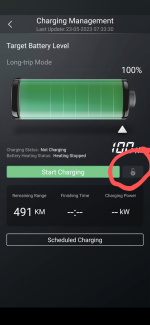

I did find this strange lock icon on the battery screen of the iSmart App. Does anybody know what it's for?

Is that not the lock status of the charge port? As in whether or not the cable is locked in place.
Honestly, I have no idea! I'm just looking for reasons why the car failed a few scheduled charges, but what you say would make sense.
Thanks for the confirmation. I guess I can rule that one out as a cause of the problem. Confusingly, the MyEnergi App also has a "lock" symbol that needs to be open to permit charging.
That’s probably because it’s got a lock set on the actual unit like mine is. I have to put a passcode in whenever I charge mine.

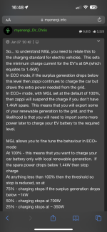

Although according to Dr Chris at MyEnergi there’s a minimum standard for this so maybe not entirely an MG issue?

Yes, minimum charging charging current is 1.4 as a standard, but it's how it's been implemented within a car that comes into question. So how the car responds to seeing an input at 1.5 for example, it should immediately wake and initiate charging. This however is not what I am seeing with the MG, 2kwh can be exported but the car sits with 'charging aborted' until I disconnect for a few minutes and reconnect, it then initiates the charge as expected.
So it appears the car goes into sleep mode, but needs a shove to wake it or reset it before it starts charging.
