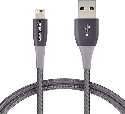

I use one of these amazon premium apple certified cables, very good quality and a good length for our use, work perfect for apple car play.
I ended up buying a box of them and have put the rest I didn't want on ebay.
