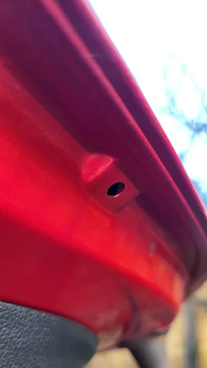

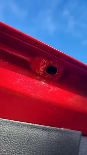

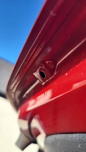

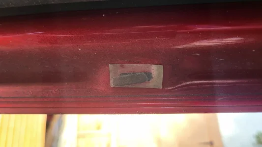

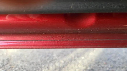

Few areas on mine I've found some rust this morning, this is along with the couple of paint bubbles on the rear arch I posted about a couple of months ago.
It seems when the car was PDI'd they neglected to remove some blanking plugs in the bootlid and pieces of clear plastic covering the drain holes in the front doors. Evidence of rust along the bottom edge of passenger front door and around 2 of the 3 bootlid drain holes.
I planned to fill them all with cavity wax this morning, which is how I discovered the rust. The bootlid had little rubber bungs in 2 of the 3 holes, which negates the purpose of the holes.

Sorry to see this. We shouldn't be seeing rust like this on any car less than 10 years old these days, when looked after normally. It's a shame, as otherwise the 5 is a great all rounder.
I'm keeping mine 3 years due to these rusting issues, then it's going. I'm too old to be messing around cleaning off and painting due to rust and slapping cavity wax around on a daily workhorse. On my classics, sure, but modern cars are meant to have evolved beyond this now due to use of zinc sheet steel and such, some MG's obviously haven't :(
Certainly shouldn't, but not alot can be done about it now other than trying to treat it before it gets worse. The next owner of my car will be the scrapyard anyway, as I intend on running it into the ground, so in the long term it doesn't matter. But, it does matter that a 4 year old car with 35k miles and a full service history that is meticulously looked after, should end up the same way as an unloved 15 year old motor though. It's a shame. But I hope others will check their bootlids/bonnet shuts/door bottoms/ sill seams etc. Because if it's not sorted soon there will be a lot of sub 10 year old cars failing MOT's due to corrosion 😞
