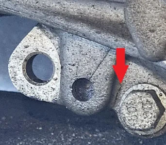

While I was having my tires changed, I decided to take a quick look at the engine side, and the part shown in the photo caught my attention. Do you think this could be a crack in the engine unit, or is it more likely to be something like a welding mark? I’ll visit the service when I have time, but I wanted to ask you first.

While I was having my tires changed, I decided to take a quick look at the engine side, and the part shown in the photo caught my attention. Do you think this could be a crack in the engine unit, or is it more likely to be something like a welding mark? I’ll visit the service when I have time, but I wanted to ask you first. View attachment 36906View attachment 36905

These parts are cast, it's almost certainly just a casting mark from the mould.

Thank you so much, it was a big relief! Since I saw the part from a distance and couldn’t touch it, I couldn’t quite understand what it was. Honestly, I got a bit worried—even though it looked like just a straight line. Thanks again!
