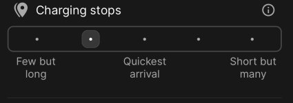

ABRP does give the options for more or fewer stops, see attached.

Yes, I did that, but it still gave me the same three stops when I put it on fewer, longer stops. Didn't offer me a two-stop option.

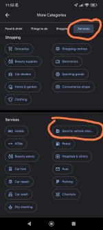

I've just looked at my Goggle Maps app, selected More and I don't see any option for EV chargers - just some pinned locations. ?‍♂️
In the Services section of the More categories on mine - Electric vehicle. Once selected, there are some options at the top of the map for plug type and fast charge. Tapping a pinned location brings up some details of the charger.
I was looking in a different place .. in the More section after tapping the search bar.
Following what you've said (and what @jpk showed) is the same as typing in Electric Vehicle Charging into the search bar. :)
