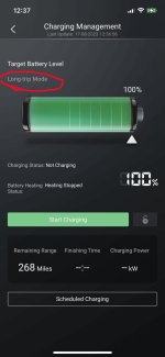

Anyone know what this means in iSMART?

The arrow shows the changing limit is 100%, this is known as long journey mode. If you slide the arrow to 80% it will change to health mode. Just indicating that you normally charge to 80% for best battery health, leaving 100% for long journeys.

Hmm.. ok thanks. So can the app actually switch off charging at a certain point then? I assumed I had to do that and the app just showed me what was happening
Yes the App will change the setting in the car.
grand. Thanks.
I guess 100% is ok for now as I am driving up to Sheffield tomorrow. But ordinarily I shall try to keep within the 20-80% range
strange that it doesn't seem to mention in the manual that the car can automatically switch off charging at a certain point. Good to know!

FWIW. The option to charge to anything other than 100% is only available on the long range battery.
Yes. If you have the SR battery the "long trip mode" and "health mode" labels are irrelevant and the car will ignore all that. It wants you to charge to 100% every time you are on an AC charger, then it wants you to leave it plugged in for another half hour to to balance its cells. The app will show when it's finished.
If you don't do that, at least every week, the GOM will start lying to you and if you drive the car low you may get a nasty shock as the reported range suddenly drops not long before you run out of juice.
Just to be pedantic...
It's the cars (and only the LR models) that have the charge target, not the app as such. The app is just being a remote control for the car. You can also set the target on the infotainment screen.
When a charge reaches the target, the car will stop accepting charge, sending a message to the charger to say "no more, thanks".
It's handy in a few circumstances, depending on your lifestyle. They say you should aim for 80% on LRs, only charging to 100% in preparation for long trips. But also, for example, if you know 60% charge will get you home, you have 40%, and you're at a rapid charger that's 75p/kWh, it's nice to be able to set the target to 60% and not pay the rapid price for more juice than you need. Yeah, you can do that at the charger, sometimes, but not always, and it means working out yet another UI.
So it's a bit of a pity if you can't do it on an SE.
You can do it on an SE ... provided that you have an SE LR. ;)
BTW - the app used to show a functioning target arrow for me with my SE SR. But that changed after a couple of weeks. My guess is that it needs an account configuration on MG's server side to "disable" the target arrow.

If you have an SR in this situation you can just keep an eye on the app and stop the charge from the app when it gets to what you need. No need to go back to the charger.
The app will only stop the LR charging on round numbers anyway, and that's not always what you need.
