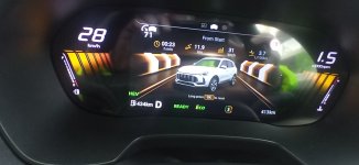

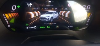

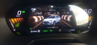

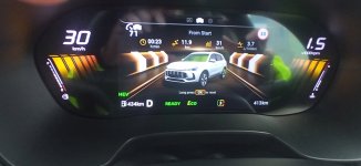

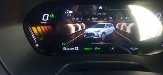

Mick78 if there is no electric heater in the car how can you put the heating on with the mg smart app?
As you can see thede figures are from today.

Set off this morning at +3 degrees, steering wheel and seat heating on, air conditioning was still off. I then set off fully electrically without the combustion engine for about 1.5 km as there is a hill at the edge of town. There the combustion engine started with a half-full battery and I switched on the air conditioning, I drove slowly up the hill, at the top the battery was still half full. Then I drove onto our highway and had to overtake a few vehicles straight away, and the accelerating used up the battery to just two bars and the combustion engine then revved up to 4000 rpm, but only until the battery was half full again, then the rpm immediately dropped. Shortly before work there was another slow stretch where the combustion engine turned at about 2000 rpm until the battery was full and then drove purely electrically.
The fuel consumption according to the BC has not changed from before. What has changed is that it revs faster at low speeds and that when the battery is being charged, it requires a little more rpm from the combustion engine when driving slowly so that the battery is charged faster without constantly revving up for short periods. The vehicle is much more relaxed and therefore also quieter.
