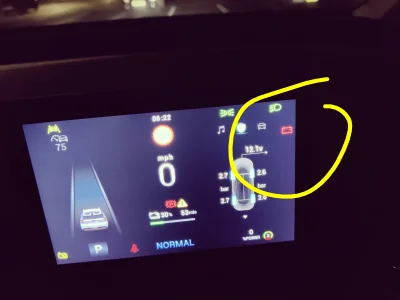

Anyone lost lights whilst driving? I was driving in the dark (thankfully on a lit stretch of road) when my headlights & I think other external lights went out, & stayed out. I'm not sure what the dashboard indications were at the time (I had bigger things to think about - like seeing where I was going!) Pulling & holding the main beam stick towards me gave me lights again (until I could pull off the road safely & wait for daylight!) When parked up, I noticed the red fault symbol for the 12V battery was lit (see picture below). The dealership have said it was a technical glitch (no s&!t Sherlock) & that I should monitor it. Is this likely to happen again? I live in a rural area where most roads aren't lit - I'm very not happy about the prospect of losing my lights driving around here! Battery fault symbol is no longer visible. I checked the battery connections and they were firm.

It also shows the high voltage battery fault and the 12V battery charging at 12.1V so presumably the HV battery is not charging the LV battery hence the problem, so the problem lies a bit deeper than the 12V battery. I have had the HV warning flash up on mine briefly but not to the extent of the 12V being discharged. Whether its a glitch which goes away on re-start or reset/ 12V battery disconnect , specific software update, who knows? Driving these cars needs a new mindset and reading of the information that's available whilst behind the wheel. I never have the 12V charging screen up as default so it means relying on the other warning lights , and noticing them , to second guess a potential problem that might occur. I would have thought the HV warning light would have been accompanied by a bong and brief message, but , all too easy to miss.

It also shows the high voltage battery fault and the 12v battery charging at 12.1v so presumably the HV battery is not charging the LV battery hence the problem, so the problem lies a bit deeper than the 12v battery. I have had the HV warning flash up on mine briefly but not to the extent of the 12v being discharged. Whether its a glitch which goes away on re-start or reset/ 12v battery disconnect , specific software update, who knows? Driving these cars needs a new mindset and reading of the information that's available whilst behind the wheel. I never have the 12v charging screen up as default so it means relying on the other warning lights , and noticing them , to second guess a potential problem that might occur. I would have thought the HV warning light would have been accompanied by a bong and brief message, but , all to easy to miss.
I think there was bong but I would have missed any message (not able to read it quickly enough, even if I'd got over the shock quick enough to try!) It all happened v quickly, & unexpectedly.

The Fault symbol indicates failure of the 12V battery charging system. (See attached image.) The manual says that if the 12V battery is low then the car will switch off some systems, not specified, so still having headlights working is correct.

Your 12V battery needs to be replaced at not holding charge, have you checked it’s charging at 14V when in ready mode, you see this when you have the tyre pressure screen up.
According to that screen mine charges at 13.8V to 13.9V ... in the iSmart app when I'm charging the car it shows at about 14.2V.
Good so we know the inverter to charge the battery is working. In the photo you put on in your 1st post I see the car is not in ready mode, do you do this a lot as the 12v battery is not been charged and is drawing on the battery and if low will come up with the red battery as in the photo.
You can buy a 12v battery charger and give the 12v battery a charge from that and if that keeps you 12v top up and you do not get the problem again all good. If it should happen again check to see if you are seeing the 14,2v charge in ready mode and it’s there then the battery needs to be replaced as may not holding charge to me as the lighting eg take very low draw on the battery. You may have dead cell in the 12v battery and this will reduce the capacity of the battery.
