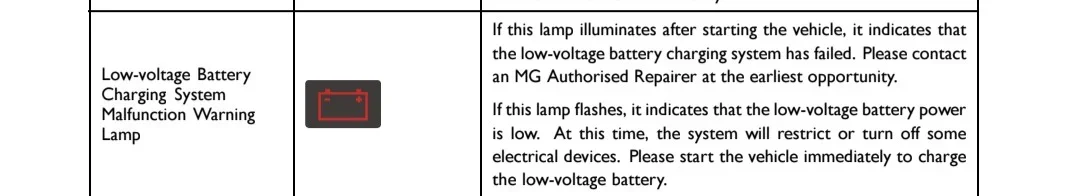

The Fault symbol indicates failure of the 12V battery charging system. (See attached image.) The manual says that if the 12V battery is low then the car will switch off some systems, not specified, so still having headlights working is correct.
My own experiences with this battery charging failure, reported elsewhere, in October 2023 and July 2024 have not been repeated and the car has not had any non-campaign updates. I have not changed the battery. MG4 Trophy bought April 2023.Screenshot_20251216-150007.Moto App Launcher~2.webp
