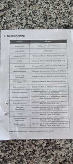

I guess that is helpfull, but I do not know the meanings

After long discussion with the dealer and involving the MG head office in Bangkok, finally MG sent another technician to check. This one took the time and really checked the charger.
As suspected by me and told MG three weeks ago the charger is simply broken.
They will replace it but it will take minimum 4 weeks to do so.
I hope I can give a final update by then.
update:
MG still did not replace the broken charger and told me now, maybe end of December. That would than be 4 months.
In the meantime I bought another wall charger from another company, connected it and it worked at the first try.
