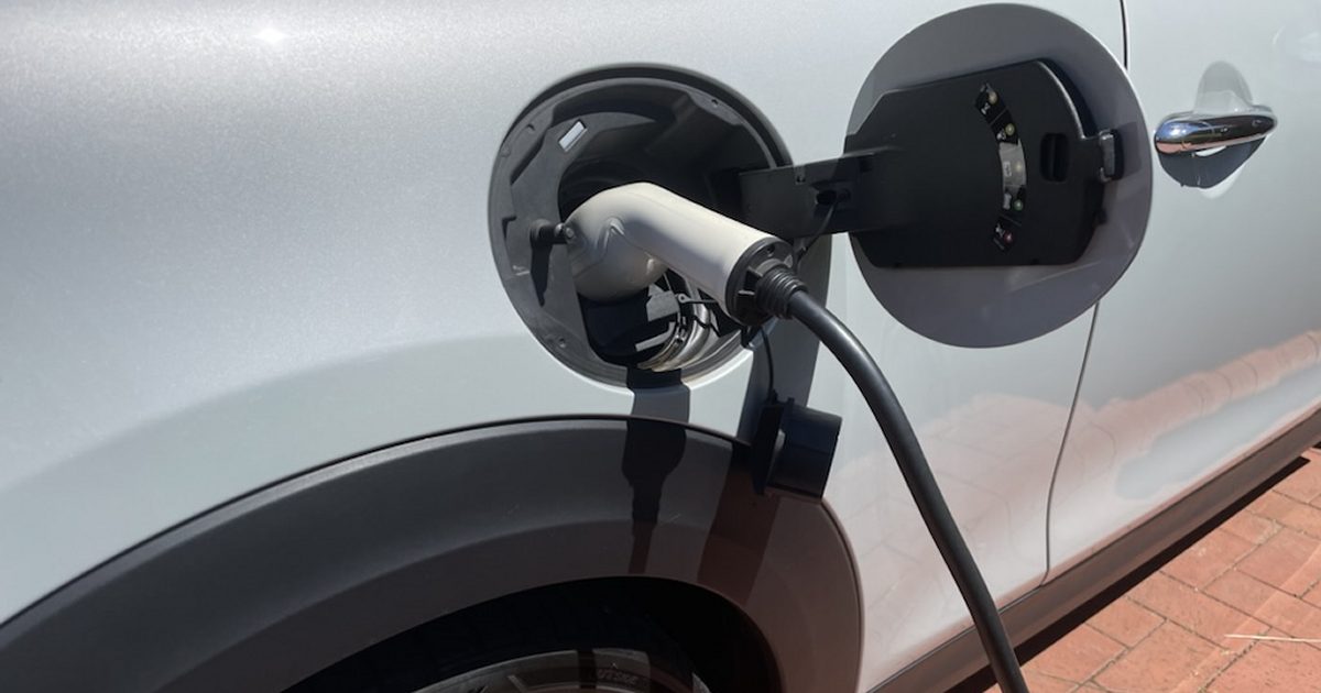

I have nothing intelligent or high tech.
I have a generic 15A charger off Ebay ($227 AUD). Before charging I observe the solar inverter output and set the charge rate before connecting it to the car.
My friend who has an EV6GT bought a 32A professionally installed unit for $3200 AUD, but only uses it at 15A :p
