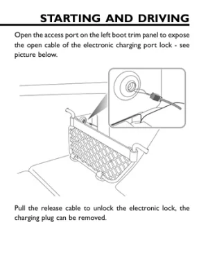

How about a simple modification by attaching a wire to the existing manual plug release in the boot and extend it to also manually release the central locking flap (Charger Door) switch 🤔 Personally I am still of the view that this is a design oversight…..not to have a manual override device.
I forgot to add this….for reference

Four different things:
1. Charge plug lock: locks the charge plug into the car's port while the car is charging. Emergency release cord in the boot, in most models.
2. Charge flap lock: locks the charge flap while not charging (ie shut), normally operated via the keyfob / doors, to lock and unlock.
3. Charge flap latch: opens the charge flap in response to a push in, spring loaded. Can be bypassed on some models by removing charge flap cover and then using suitable bit to open lock mechanism - eg if frozen.
4. Charge flap cover: body-colour plastic piece covering the charge flap latch/lock mechanism. Normally removable by pulling the cover in the right direction.
I think this is right, others will correct me.

This fault has to be fixed and how can anyone think that it is not a design fault/error to not have a manual override for putting fuel in any car, let alone an all electric/electronic vehicle. There IS a manual override to open the doors/boot/bonnet and to release the charge plug from the socket BUT NOT to open the fuel/charger door 🤬 Without a simple solution these cars become a very very expensive ORNAMENT at a charging station 😢
