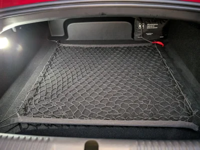

Hi, I'm just a "Newbie" but thought I'd share a small mod I have done to my car. In my previous cars (particularly the BMWs where they are available as OEM accessory) I have had a "cargo net" in the boot. I did a quick search and I couldn't find anything for the Cyberster so I thought I'd have a go myself. I used a net that I had in my BMW M240i and then in my Taycan 4s. In both these cars there are metal D rings to attach "tie downs" or a net.
However there isn't anything specific in the Cyberster. The rear of the boot is no problem as there are the metal brackets for the small net pockets, but nothing really to attach to on the front bulkhead. I didn't want to drill any holes or attach with a permanent adhesive, so I came up with a solution for the "anchors" using "velcro" like hook and loop fasteners and a keyring, that attach to the floor panel that covers the tyre repair kit.

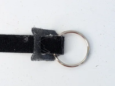

The anchors

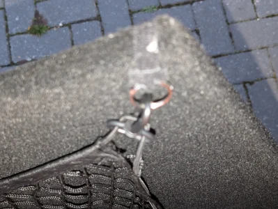

The fastener is a "hook and loop" cable tidy with a 20mm split ring. The loop in the fastener is secured with some contact adhesive (pictured before I cleaned off the excess)

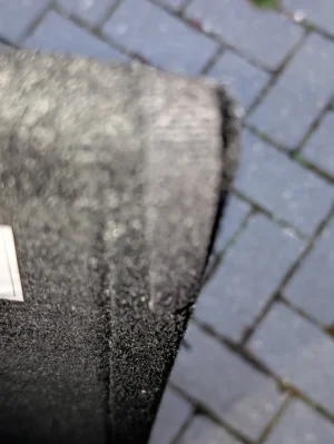

It is attached to floor panel using the hook side and wrapped around the edge: The fasteners are practically the same colour as the carpet fabric so don't stand out is the photos (which also means that you can't really see them in the car!)
Attachment = Top
Attachment Bottom
Installed !
(ignore the red ribbon this is for someone who is vertically challenged to reach the first aid kit)
Hope this helps someone else! If you have any queries post them and I'll try to answer.
