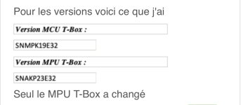

I think the update Is snakp23e32
Before and after the visit. MPU T-BOX was 18E32.

Yup, the SNAKP23E32 made it significantly better for me too.
It still often fails as I go into the app sometimes with an error message sometimes not. So far if I then try the status page, it has always worked. Even having left the car and app untouched for 4 days on one occasion, it has still worked.
It's not had enough variable use for me to believe it's definitely fixed yet.
ETA: Assuming the improvements I've seen are real, it will only have addressed one or two of the reasons people have been having problems as listed by @tsabove. But it's a good start ?.
