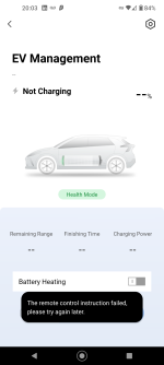

Since updating to the new version its very temperamental showing me the charging status on the app. For example, its charging now to 80%, I can open the app and it scans the car ok. But when I go on the battery tab to check how the charging is going, it just hangs and says remote control fail. The servers must be ok and its connecting to the car, otherwise it wouldn't scan. A little frustrating, as I can't see now if the charging is finished on the app, I have to go and look out of the window to see if the lights have gone off green.

Yes it worked fine before.
I've tried everything apart from uninstalling the app and installing again. I figured that if the app is scanning the car ok, then the app should be ok.
Another thing is happening since the new app that I forgot to mention. Before the new app, I plugged the car in, went indoors, opened the app, and started the charge, no bother. Now, when I first start the charge on the app it tells me that the cable isn't connected. I then go outside, unlock the car, take the cable out, put the cable back in and lock the car. I then go to the app and start the charge ok. So it always works, but never the first time!

Just an update on the charging part of the app. I suddenly lost connection to this part. I uninstall & reinstall the app but it made no difference. the version is now ver 2.02.
On that note I have another phone which has the app on it but not registered to my account, this has the app ver 2.01. I quickly logged in on this to see if there would be any difference. But no I get the same error message.
Conclusion it is nothing to do with the app.
