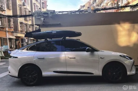

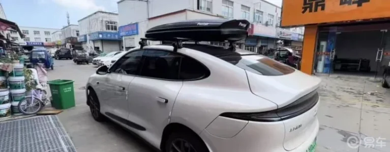

Right. So after some very thorough digging through Chinese sites, forums etc I found the following:
If someone could tell me what the brand of the roof bars is :)

Was your merc with frameless doors? This is what I am struggling with..The model that will fit on the frameless doors that the IM has..
Hi Nick I think they are indeed Thule, if so they come over the top of the car and fix to the bodywork above the door. Nip in to Halfords, they stock all the different Thule roof bars and different fixings, they will be able to advise which part number fits ( then you can go online and see who does them the cheapest 🤣😂)
Will try and do this. I am not so sure they will be helpful though. Neighbour of mine with the Dacia Spring went over and they told him that the car is not on our lists as roof bar compatible so we cannot help you....
He got a cruz one online which fits perfectly based on user recommendations.
Try Roof Bars from The Roof Box Company . They are online only but very helpful and responsive to queries.
Just had a look on the Thule site - im6 is listed but no fittings yet approved
Will try and go over to Halfords next week and see if I can get anything out of them. nothing available online at the moment. It seems none wants to take the risk of suggesting something.

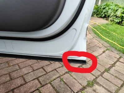

One more thing I wanted to raise yesterday and run out of time. The last couple of days I had a really annoying creaking sound coming from the interior of the car. I was under the impression it was from the B pillar on driver's site.
Gave a good squeeze on various plastics around that area; no joy. Lubricated the door seals; made no difference whatsoever.
As I went home yesterday I opened the door and starting checking again. Then I noticed the end of the plastic clip at the bottom of the door. Squeezed it gently and it creaked....Put some foam tape around it and hoped for the best.
Voila, problem solved.
I am attaching a photo for clarity.

Roof bars wise apparently Thule wingbar with the 7205 footings.
