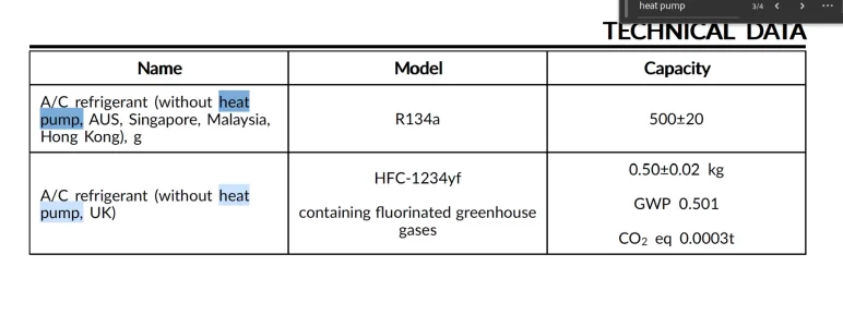

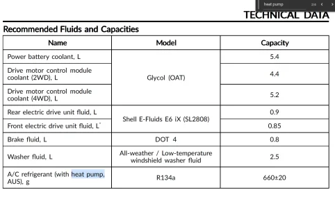

Found these references to the Heat Pump, fuses and countries fitted in the User Manual.
