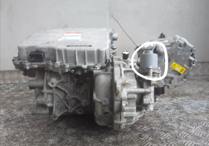

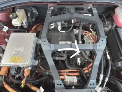

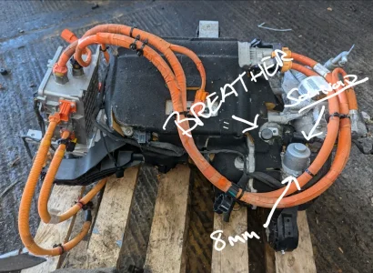

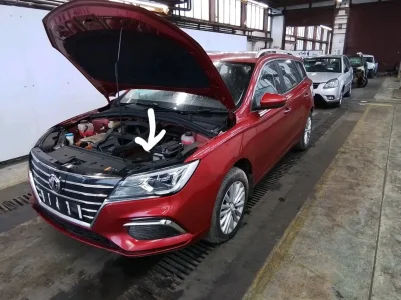

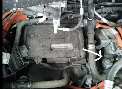

The original documents only show the manual on that doesnt exist on the LR and further. You need to remove the electric solenoid on top of the selector module. Its located to the right of the main motor.
Once released the gearbox will be in Neutral then you can release the handbrake and role the car around.
I have attached a few photos to show location and the solenoid itself.
