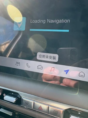

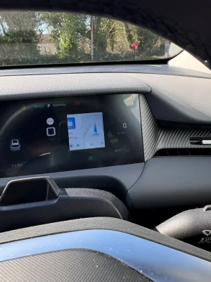

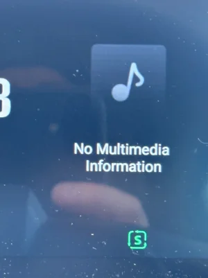

If you read back through this thread, or, indeed, almost any posting on this thread, you'll see that it is a worldwide problem, nothing to do with your car.On the way home last night my in my MGS5 the central entertainment screen went faulty - none of the buttons worked and when they did were very slow. Even when I try to change system on steering wheel the system would not work - Is this fault due to the fact that only last week I had my first 15,000 mile service and the garage was unable to reset the service mileage due to their WIFI was down. Is there something I can do to reset the entertainment system myself?
Worked for me! Thank you…I have turned off data in the global data setting,
Mee too!Worked for me! Thank you…
