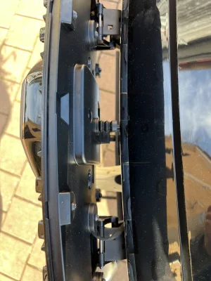

Just brought my 1st Gen 2020 ZS EV to my 4th service and they told me they have a recall for the charging door.
