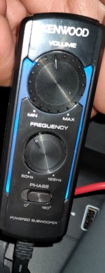

FYI here are my audio settings for the Kenwood sub and for the headunit. After a good week of playing with numerous settings this is what I find best for a range of sources and very please with the upgrade results for under £180
Parts used:
Kenwood KSC-SW11 Active sub £110
Mini Fuse spurs for sub power wiring £7
Renegade 6.5" RX6.2C component speakers for fronts door and pillar tweeters £45
6.5" speaker door adapters pair £12.99
This might help when you've fitted yours or at least starting point. As you can see from the photos the 3d surround is off, virtual sub off, push the speakers forward (rears off) and eq aimed more toward mids and treble for the front components. This let's the sub do what it should do and reduce bass from the doors for better midrange and rear speakers off/low. This now sounds more natural, crisp at low to high volume without distortion, well to me it does. 😁
Parts used:
Thanks Neil, that's very helpful, I await my delivery of the sub, not yet gone full on speaker change but may consider at a later date. 😀
I think the sub should be enough but those settings help to reduce the bass from the doors. Look forward to hearing about yours when done 👍
