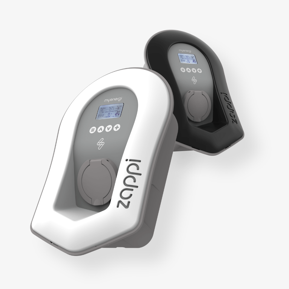

Ok that looks pretty good, I was thinking of the Zappi, priced a little higher ($1300), it's the install where the price goes up significantly from what it seems.
I'm thinking of waiting a while, I'm not convinced it needs to be smart if I just plug it in during the day, especially this summer (to draw from my solar).
I had the Zappi priced. Funnily enough, once all the gizmos and gadgets were installed (the zappi is like the Jetstar of wall connectors) it was $2,800. ($1,900 or so just for the zappi)
