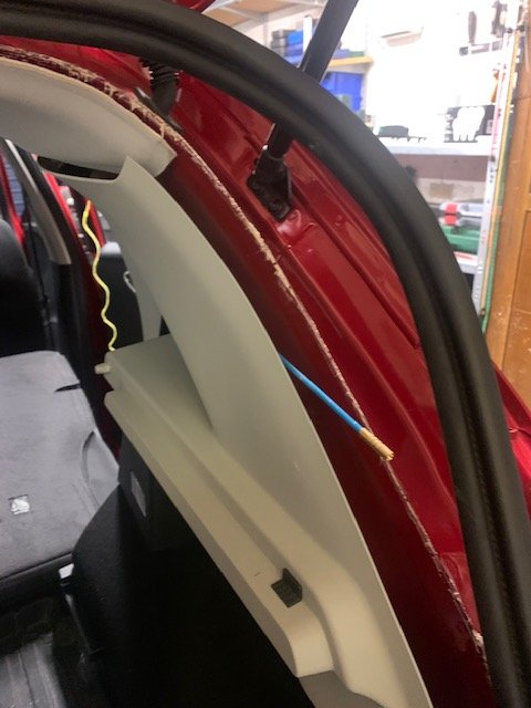

Hi Lovemyev, the cost was almost £400 from Ali express (an car). the the most difficult part was installing the cables through the headlining, especially threading them through the rubber conduits at the tailgate hinges, to ease the passage through the conduits I used washing-up liquid to lubricate them. Although the installation instructions were a bit enigmatic with the terminology, I must say that the system is well designed and thought out

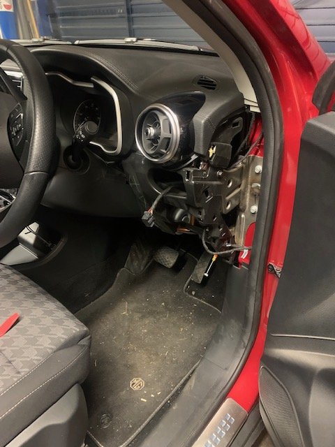

View attachment 15163Finally got round to fitting the tailgate from Aliexpress, routing the cables was not as difficult as I first thought, the worst part was threading the cables through the flexible rubber conduits at the tailgate hinge. I've included some photos of the installationView attachment 15163View attachment 15164View attachment 15165View attachment 15166View attachment 15167View attachment 15168View attachment 15169

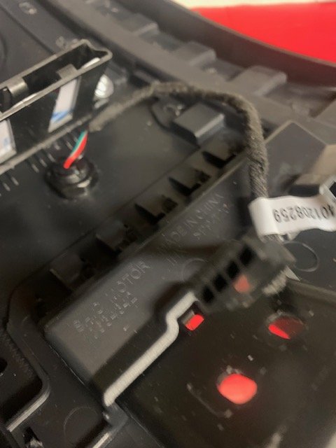

Many thanks for coming back to me. I have the connector in the pillar b that they say to get to in order to connect the green wire to. I believe its for the central locking but the colours are different.
Any info is greatly appreciated.

Also. The fuse box is on the passenger side of my car. Did you have to extend the cables for the button you have under your card slot? There is only 200mm on my cable for that button and the part where the connector clips in to is at the end of the loom that is at the fuse box, so no slack there.
So, I have located the cable. Its the purple/pink wire in that loom on pillar b. It's the only cable that has 12v in it during the unlock cycle.
