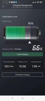

I am using standard charger at home now. 77KW battery, 3 hours for topping up about 10%
