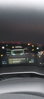

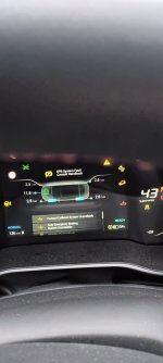

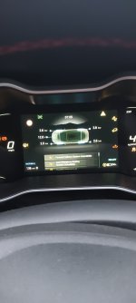

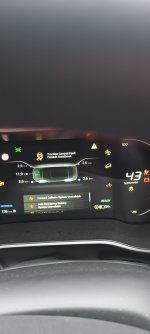

This is NOT right..

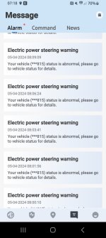

The key fault warning there was the accessory battery at 11.9V! That would be the cause of all your problems. With the car on it should show at least 13V.

Its a separate issue, but I did notice your tyres are reporting below 2.8 bar. Might be worth pumping them up as you/dealer replaces the 12V battery.
As others have already stated, the likely root cause of the multiple fault codes being generated, was an issue caused by either a low state of charge in the original factory battery, which can become so discharged, it becomes unrecoverable, so now becomes a defective battery.
This issue MAY have manifested itself as a result of the one of the terminals not being tightened correctly, as you have stated.
When the car detects multiple errors in rapid succession, it struggles to deal with the high volume of errors and can result a complete shut down of the system.

All those trouble codes are likely false positives from the 12V battery issues. Get them cleared, or clear them yourself with an OBD2 app, and see which if any return.
The 12V battery can cause issues to be reported that are truly scary. This is the case with other EVs as well, at least the Nissan Leaf and Mitsubishi iMiEV that I'm familiar with.
