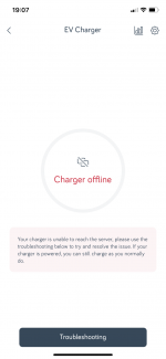

Hi Everyone,
Im hoping someone can help me, im having massive problems with the app when trying to charge the car at home. The charger i have half the time is offline and unable to reach the server but it says i should be able to charge manually. But i have never managed to do it. I open the app and click charge i get the message sending tab come up and it says failed. Im not sure if its the car or the charger thats the problem. I have had to take it to a public charging point and it did work. Just not sure if I'm doing something wrong

Its the hive charger. But that says i should be able to charge manually when the server is offline.

Jojodie, Siteguru, forget the app for a moment. In the car menu is there a manual charge/schedule off setting. If so go to manual charge, plug the charger in and it should charge immediately. Let's not get the app involved until we know the basic charge works. If it doesn't ? at the charger
I have just removed the charger put it back in gone into the car pressed it on the dash and i just get the connected not charging message. I have switched off the charging schedule just encase it started confusing itself

Its not stopped at 80% it hasn't started, thats what i finished on when i got home, im on a long trip tomorrow so needed it at 100% for the morning. Good point about the schedule on the hive app its set to a charge from midnight so potentially its stuck until it goes back online and i can’t remove that because its offline. Hive never sent any instructions with the charger. Its just so stressful when you rely on it to work. Thank you
