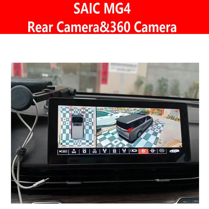

how would the 360 camera work, wouldn't that require a camera to also be installed in the front of the car? ( which would mean maybe the front bumper assembly needs to be changed?)
The Trophy has front and rear cameras as well as one in the bottom of each door mirror so you would need to change the door mirrors too.
You would also need the software to stitch the images seamlessly together and the cameras properly aligned to give the 360 top down view.
