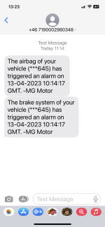

I was unlinked (de-linked?) from the MG app several weeks ago, but have received texts today from god-knows-who
They’re obviously doing something on my old car.
Maybe some poor sod is taking SP72 ZXA on ?
+46 is phone from Sweden ?
That's where MG's server/mobile connection is based. (It was only when it was moved to there that I was able to register my mobile number with the app).
