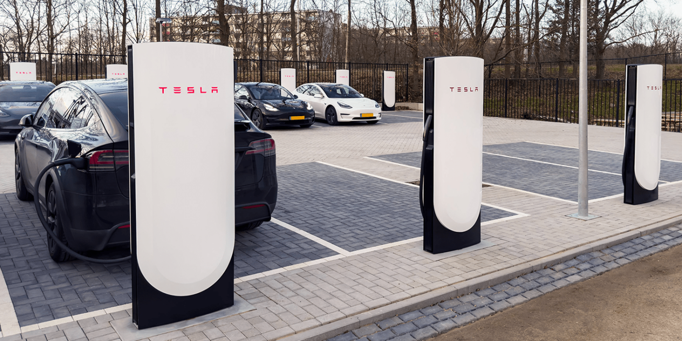

To clarify:-
If the Superchargers look like this, you'll need the app, and for Tesla to have opened the site to all users. (see map above)
Sites with these ones will be open to all from day one. The chargers have built-in card readers, touchscreens, and slightly longer cables (but also accept input from the app).
