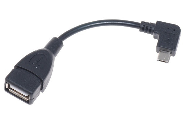

What is it do about USB OTG? Do you even know what it is used for?
OTG is just the process where a device, such as the MG's infotainment system, can be connected to a computer via a USB cable and then viewed as disk storage. This then allows files to be directly uploaded or downloaded via the computer's standard applications.
You likely use OTG without thinking about it if you connect your phone or digital camera to your PC to access images. Even the humble flash drive is just an OTG device
To be honest, that is not the definition I understand for OTG - On The Go. 🤷‍♂️
To me, OTG is a means of connecting external devices to the phone/tablet/car, not connecting the phone/tablet/car to a PC. In other words, OTG is the means of connecting external storage, a mouse, a keyboard, etc. to the phone/tablet/car.
There may be similarities (i.e. they both involve using the USB port) but they're not the same thing.
But, the car infotainment system has data storage, and so it is a device that can be connected as storage to any other device that accepts storage.
Correct - but that is not my understanding of OTG; that's just attached storage. WiKi says:
USB On-The-Go is a specification that allows certain USB devices, such as tablets or smartphones, to function either as a host or a peripheral. This enables them to connect directly to other USB devices, such as flash drives, digital cameras, mice or keyboards. USB OTG was first introduced in late 2001. Unlike standard USB connections, which involve a fixed host and a peripheral, USB OTG allows a device to switch between these roles
Rather than copying info around you can see the detail here
If you insert a USB drive into the infotainment system's USB port, the infotainment system will recognise it as a storage device and scan it for content such as music and videos. On the other hand, if you use an OTG cable and connect the infotainment system to a computer (including a phone), it will configure itself as a storage device, allowing files to be transferred.
