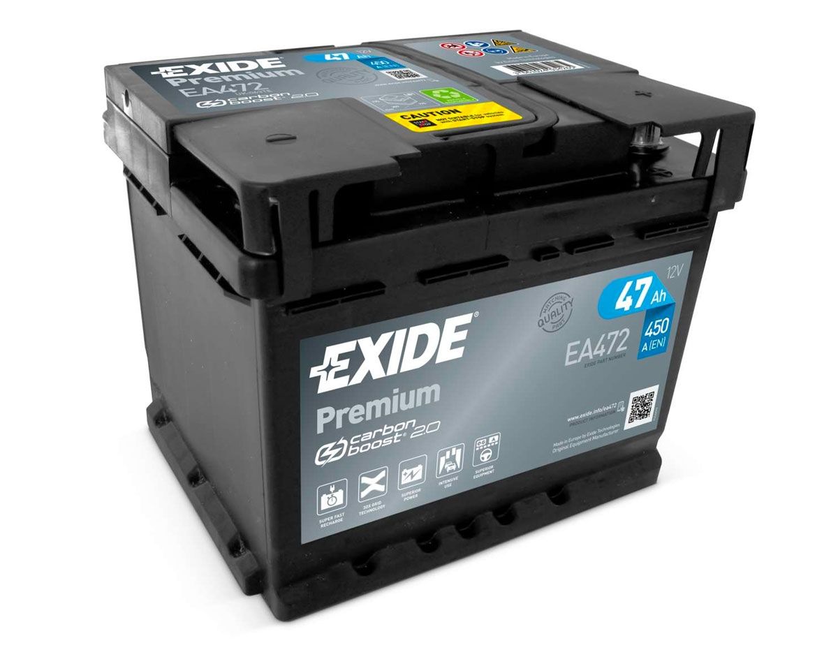

The only batteries I've found that are a match

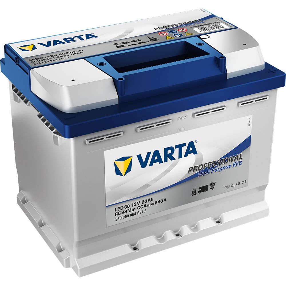

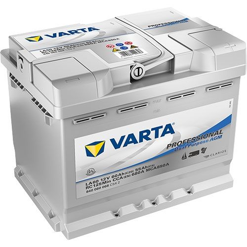

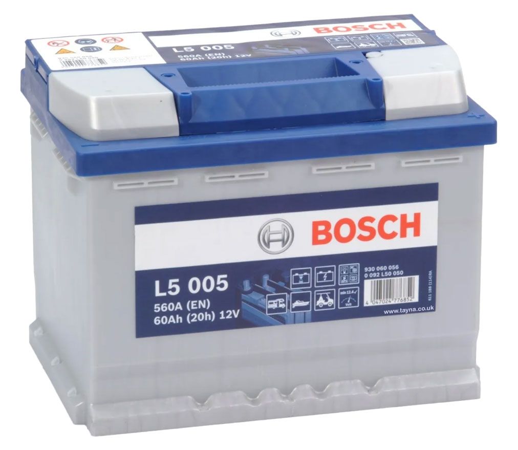

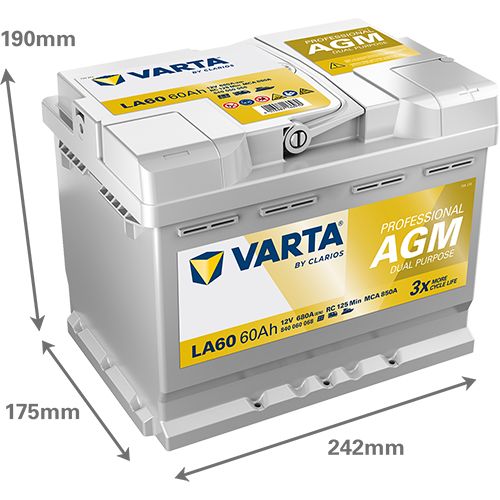

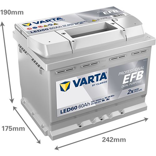

I've found the following Leisure batteries that appear to fit, however I'm not sure on the different types of batteries, AGM, Wet, EFB
