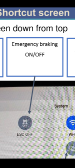

@Grriff . Appendix D. ESC is described as "Emergency Braking", should that not be "Electronic Stability Control" which is a different and more dangerous animal.

@MarcS . I've done some more research. As you are probably aware the manual states:
Stability Control System ( SCS ) and Traction Control System ( TCS )
SCS is designed to assist the driver in control of driving direction. When SCS detects that the vehicle is not moving in the intended direction, it will intervene by applying brake force to selected wheels or through the power system management system to prevent sliding and assist in bringing
the vehicle back to the right direction.
TCS contributes to maintain the control to the vehicle by improving the vehicle's traction trafficability and driving stability. TCS monitors the driving speed of each wheel
individually. If spin is detected on one wheel, the system automatically brakes that wheel, transferring torque to the opposite, non-spinning wheel. If both wheels are spinning,
the power system output torque will be reduced until
traction is regained.
SCS and TCS are automatically switched on when the vehicle is powered on. And they can be switched off by using the switch located within the Infotainment display.
Note: Disabling SCS and TCS will not affect the operation of ABS . Always disable SCS and TCS when
driving with snow chains fitted.
The main purpose of the button on the shortcut screen therefore appears to be to turn off these control systems if snow chains are fitted. I've amended my guide accordingly.
Thanks again for your help.
