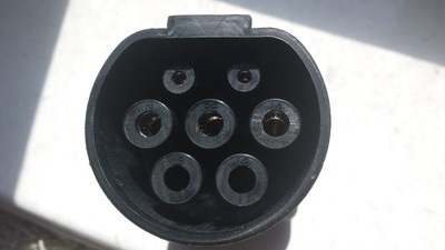

Well, I've done the experiment of ordering the cheaper option, with the socket for Oz vehicles, via eBay. All good until I tested it. I get an error message that the discharge cable is not connected. Perhaps I am missing something?
Looks like the resistance between the PP and the Earth is the wrong value - it should be 460 Ohm. Have you purchased an MG specific one or a general one?
The error shown implies that it's a resistance that tells the car to expect a charge.
