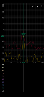

No problem, I have a wireless mic that I found I could clip onto the steering wheel and I found an audio spectrum analyser program on the play store that works with it.
I've done one test today at 110kph on cruise control and there is a distinct peak at 43.9Hz which as you pointed out coincides very precisely with 3 times the rotational speed of the wheels.
I also noticed that the vibration seemed to get worse when I was going round bends and was less noticeable on the straight.
Overall it does seem to be a lot less noticeable now the car has a few thousand kilometres on it than it was when we first got it.
