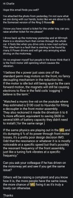

So, what a curve ball!
The rear driveshaft??
I'm claiming that as a win then.
On October 6th 2023 I said it will be driveshaft related (Albeit I put it down to the fronts for obvious reasons)
Feels like there is some real momentum going on now.
Better late than never.
