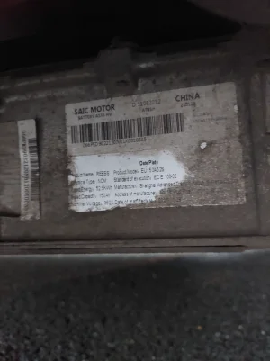

Not true regarding SR and lfp.
I have a 2021 Pre-FL and it has a NMC battery.
Hi m4rmite, i think thats the same as Mickey was saying? Pre-FL NMC. Aft-FL the LR remains NMC and the SR got a LFP.
Ahh I see, sr on face lifts got lfp.
The lfp rumour was going round on pre face lift models as well, so I was gutted when it was a nmc as per my picture.
