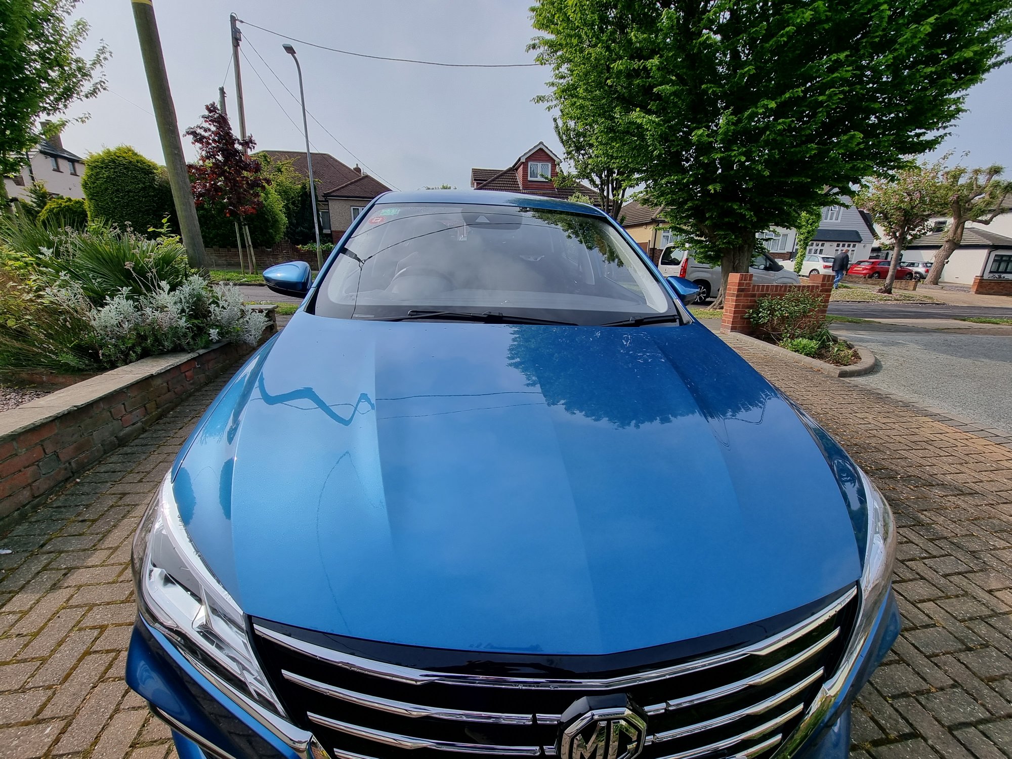

Hi Jomarkh... I have an MG 5LR....what frunk??
Its a front trunk, if you open the bonnet there is a plastic cover that has a dip in it it's just enough room for type 2 charge lead, some have taken the cover and it's supports off and put a plastic box inside to have a storage area.
Didn't think it would fit but was pleasantly surprised when I tried it?
