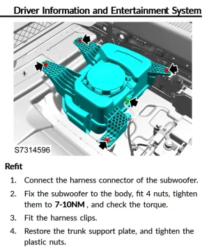

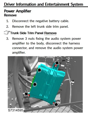

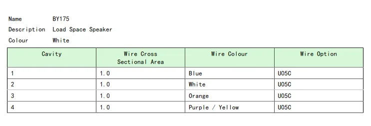

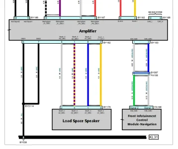

Yes, seems like the amplifier is located behind the lefthand trunk sidepanel. The woofer itself i just connected with high-level inputs (it's a 2 channel input, have not checked if it is twin woofer or just dual-coil). Looking to find a spare connector (BY175) to avoid cutting the original wiring. I got myself an amplifier from RECOIL that is supposed to "power on" automatically by the high level input.

From the service manual. Downloaded it from MG website. Payed 6€ for 1 hour access.
