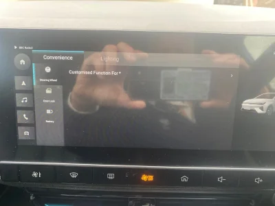

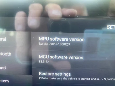

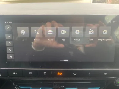

    Here are the screenshots of the Infotainment
Which dealer did it come from? Not seen version 1300 R07 installed on a later Trophy. You need to challenge them on it in the first instance.
Mine came with R12 which was current at the time of manufacture (March ‘23)
Have since updated to R17 myself as purchasing dealer was both useless and far away.
