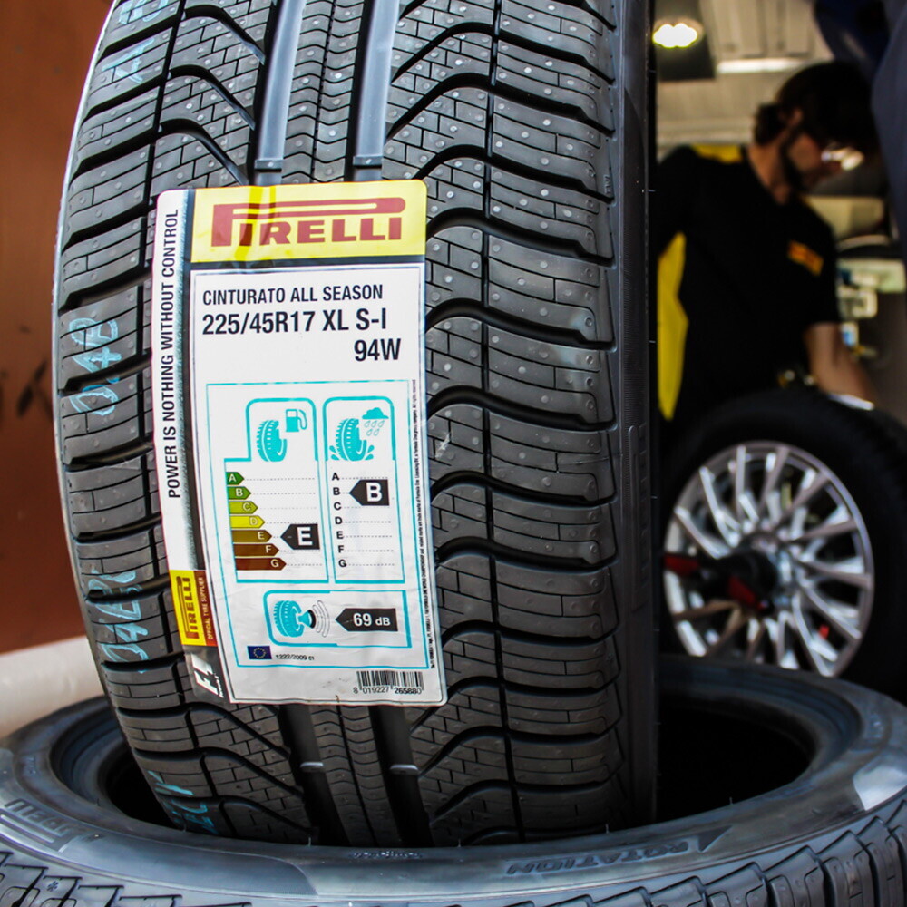

I've read quite a few posts on here around how larger wheels affect efficiency, can anyone supply some science to collaborate this as if the overall diameter remains the same how can the efficiency change. I ask this as it's now confirmed that the my23 cars will come with larger rims but the ranges haven't been modified to reflect any efficiency changes.
Err Google it? e.g.
or
In addition, larger dia needs greater force to initate and maintain speed (its a lever thing). This being offset by greater distance per revolution. Its hitting that sweet spot alluded to in the Pirelli article
