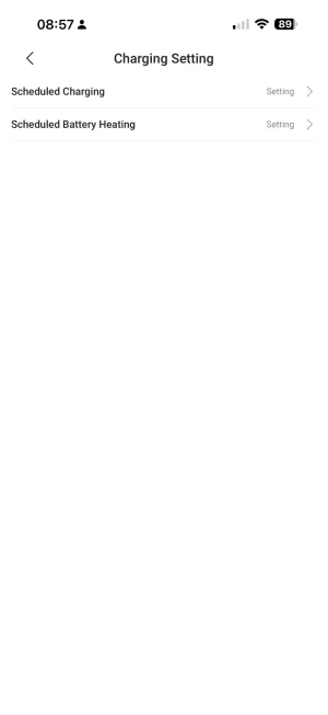

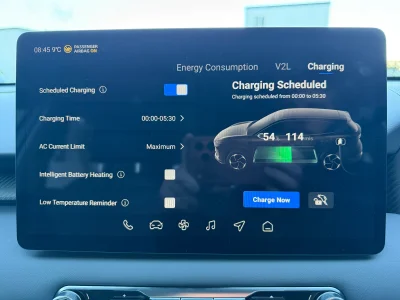

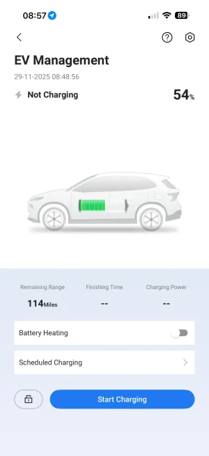

I’m a new owner of an S5 SE long range. I don’t seem to be able to set a charge limit, and there is no option to do so in the car or on the iOS app. It strikes me as a little odd as my partner has an S5 Trophy and she is able to set hers to 80% no problem! Is this feature locked to the Trophy model?
My MPU version is DS04A_MZS3E_20250328_1014_V, TBOX version 01M9F8U062 and ISA version 2024.Q2.

It's not available on the SE but should be on the LR as it has the same battery type as the Trophy.
