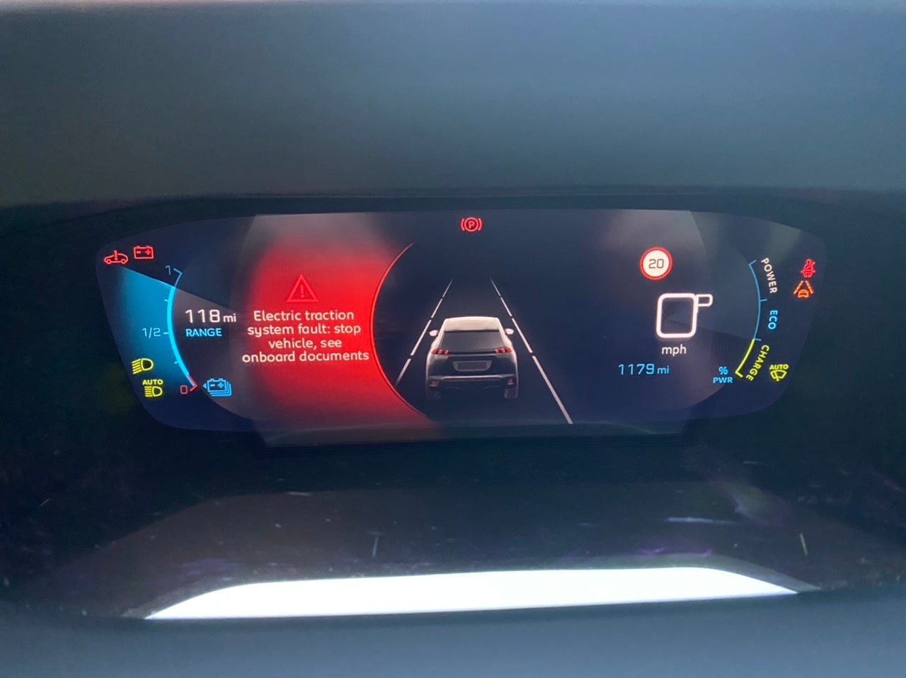

Drove into work this morning, and just in the last few hundred yards, HV Battery disconnected ?‍♂️ Out with the socket set, and the negative lead gets pulled. Wait for while, reconnect, everything that should clunk did so, and off we went. No big deal thinks I.
Finished my work, and heads off. ¼ of a mile later...same again. And again, and again ?‍♂️
Let's see how this pans out. MG Assistance on the way.
I see it sometimes when I'm too quick for the system when starting and selecting D or R before READY is fully displayed. Slowing down and starting again always works. This seems like a new development so you were moving when it happened? I have had it once where I had to put in N and push car (5SR) out of way of other traffic but I was static in queue of cars at the time press the go pedal and that caption came up and it would not go even with the classic switch it Off and On again. Bad luck hope all works out well. Interesting that the AA Man didn't have a quick fix as he will have some EV experience? Keep us all informed please.:sick:
Let's see how this pans out. MG Assistance on the way.View attachment 7023

I hope that you get it sorted. Exactly what happened when you say hv battery disconnected? Any warning lights? Loss of drive? Loss of all power?
Was stopped at lights, and when I went to move away, there was no power. Fault lights for HV battery and I think a general fault (Red, exclamation mark inside either battery or a triangle (it was daft am this morning))
When it happened again after I left work, it happened whilst moving. Loss of HV battery, Vehicle Control System fault on the centre display, same array of warning lights.
Got it cleared again, but it happened again multiple times.
On the upside, when the traction battery disconnects, it freewheels to a stop... on the downside, once it stops, it puts the handbrake on, so you're stuck there.
