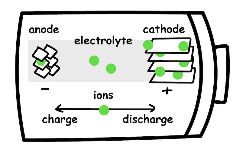

Actually most EV brands have such advice as most Lithium battery [edit: LFP being the exception] have two stages that are known to shorten its lifecycle if left in a prolonged stage: 100% charged or completely empty.
Therefore it’s not recommended to charge a battery fully and let it sit for days or even worse have it charging all the time.
No problem if you charge to 100% occasionally as recommended to allow for cell balancing or in preparation of a long journey.
While EV battery technology has improved greatly over the past decade, it’s still better in the long run not to constantly test the limits as few need the full range on a daily basis..
Actually this is the MG advice and based on scientific evidence, any Lithium battery has two stages that are known to shorten its lifecycle if left in a prolonged stage: 100% charged or completely empty.

Actually most EV brands have such advice as any Lithium battery has two stages that are known to shorten its lifecycle if left in a prolonged stage: 100% charged or completely empty.
