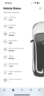

Just checked and it's taking the Michael now!

Had my app do a John McEnroe on me with the inside temp, 12th of Jan in Scotland...You cannot be serious!!! So it might just be a software glitch of the sensor has an issue. Mine was OK after a couple of days and went back to expected readings.

On mine I always do 3 refreshes to get consistent results, as quickly as possible to minimise the systems powered up time.
The voltage starts about .2 to .5 above its final value. A voltmeter confirms this is about right and it matches the clicks of relays turning on.
The internal temp is 87 30% of the time on first refresh, then settles down to between 2 and 10 degrees above external (worse accuracy in the cold).
The external is dash dash about 20% of the time on first refresh then about right.
All liveable with once you get used to it unless the 'operation did not complete' message occurs which requires a full power up and then sometimes to wait a few hours. Been free of that for a week now so looking hopeful.
