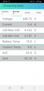

March 2020 Exclusive @ 21500ish miles & checked the SOH a few weeks ago @ 95.18% which dropped like a stone from 31st March 2021 @ SOH 99.95 & 13000miles. I haven't used a rapid in over a year & even then only about 20 times since new, 7kw charging only and still seeing significant degradation in the last 6 months. Suspect it may have also been affected by the software updates which were done in Feb 17th during a door wiring repair & March 31st service, changing charging behaviour & bms management. Not saying its making it worse just maybe being more honest. If I reset the trip meter, turn off the heating & stick in in eco gom reads 170 miles range, drive normal mode with heating on 139. So not much difference from new as far as the goms concerned.

It feels like it's degrading 100x faster, because it feels like it only degraded 0.05 from new to March 2021. But in March you happened to catch it just below 100% for the first time; it might have started at 115% for all we know, but still displayed as 100.0%. So it could still be (and hopefully is) that the degradation is slowing down after an initial rapid fall. The next drop should confirm or deny that theory.
Then there is also the effect of temperature. I'm noticing that my LFP house battery has considerably different capacity depending on temperature. So expect the apparent degradation to be worst in winter, better in summer, and there could even be some recovery of apparent capacity between winter and summer. You really need to graph it and average or otherwise smooth the data to see what's really happening.
