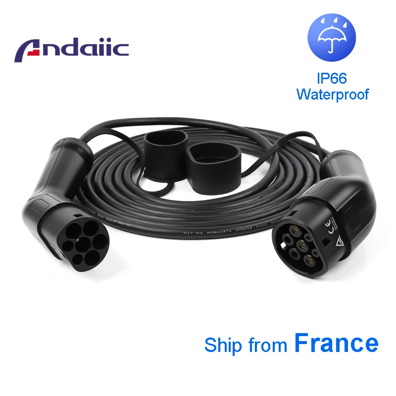

This helps a lot - thanks. There was a link to a 3 phase cable on another thread which i was going to but then noticed its kW rating was less than 11kw so wasn't sure if it was correct. I'll make sure it's a 22kw one.
Yes, 3 phase 32A 22kw the cable should say 5G6mm2+1x0.5mm2 450/750V
I was going to fabricate my own but this cost me 109.21 euros after discounts in aliexpress (i did buy at black friday time) or about 94 pounds so wasn't worth my time and in any case probable would find it difficult to buy the bits for that price and i have to say it is excellent quality, They send it from france so only took about 5 days.
this is the one i bought if of any interest, make sure you choose the right cable it was the one on the far right when i bought
