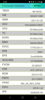

I saw that there are plug ins for the torque pro, maybe I could make one... I need to look into it properly after I get my dongle.
Added @Septian car data.
Yours has a new version change not seen before - for TC.
Assuming that's Traction Control.
Any idea what you could have on your car that's different?
@Kithmo could you share your version data?
@AbuG / @shikoku14 / @Septian
Can you answer the following about your cars, to try to figure out the differences (SCU/TC/BMS/EVCC/EPS):
When were your cars registered?
Have you got Comfort 2 (already on the car or you got it updated)?
What BMS do you think you have (when did it last have a BMS update)?
Can you charge AC unlocked?
Do you think you have the updates to allow timed/smart chargers?
Thoughts:
If EPS is Electronic Power Steering, then I wonder if this could somehow be tied to the MODE button, as the steering changes dependant on the mode?
I wonder if TC is Traction Control, then if it could also somehow be tied to the MODE button??
I presume the versions of the ECUs shown don't change dependant on the mode the car is it? I can't see how this could be the case, but just in case can you try it?
cheers
Jody

Ok,
Car was registered Sept 2020, It already had the comfort 2 installed.
I had the BMS updated at the start of October (It's the "slightly" dodgy one that takes hours to equalise, still get 455v at full charge)
It also charges unlocked, it will also wake up for a charge, but if the charge stops for any reason (Peak charging or whatever) it will not re-awaken to carry on charging
In terms of what is different for my car regarding TC, I have no idea, the dealer I originally bought the car from had no clue about updates so I took it to a MUCH better dealer and they re-applied all the updates (Except Comfort 2) at the start of October for me FOC, so maybe that's the difference. In terms of your MODE theory, I always drive in Normal.

My car was pre -reg Dec 2020.
Bought 14th Jan 2021. Was up dated then according to dealer (by then the Oct update was withdrawn) Max volt 456ish.
AC Charges while unlocked. Comfort2 update present
No special graphics
No special graphics

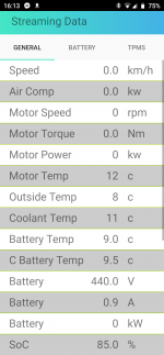

My data: (No BMS updates just Comfort 2) HV 456v fully charged.
