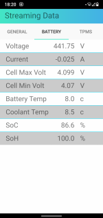

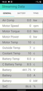

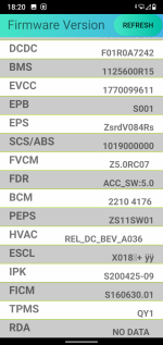

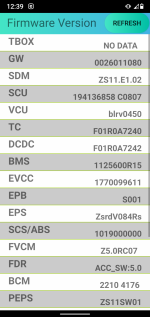

Here are my screenshots , my car is a September 2019 Excite ex demo , the comfort 2 update was done in September 2020 along with the first service , I bought the car in July 2020 and it's coming up to 10,000 miles now. Have had no issues with charging or range it's all been as expected ?

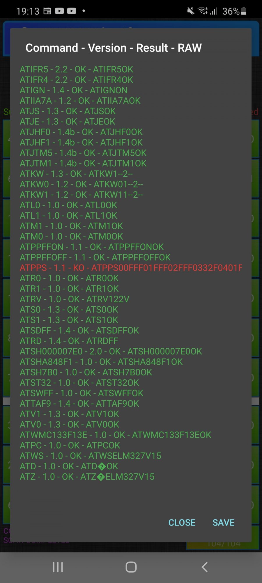

There is an app called "Elm identifier"
I think (not certain) the one we need is ATTPS 1.1 .
This was the only one missing on my first OBD2 device, that didnt work...my new one has lots of others missing but has this.

I've updated the spreadsheet: ECU Module version spreadsheet
You my friend have some new versions!
I've asked more questions over on that post if you don't mind.
@Kithmo
You have a new unknown BMS version (0106600R17) (and a different EVCC & TC)
Could you have the 12/2019 very first BMS update?
Can you AC charge unlocked?
thanks.
I can't AC charge unlocked, can on DC as expected.
AFAIK the dealer only applied the Comfort 2, pre-pickup (July 2020) and nothing else, so everything else could be old versions.
Some one else has stated their full charge after the January update with a voltage of 449V gives them a SoC 82.6%...if someone else could confirm this too (compared to my 97% at 456V..also need this confirmed too by another user).
We need to run the batteries down to under 10% and recheck Voltage and SoC for both, to see what the lower buffer is like.
Also as the numbers are so drastically different (~14%) I think it would be possible to give a bigger range by only dropping the lower buffer (at the expense of battery longevity and warranty duration)... It's possible this could have happened in the 2021 India model... If the new claimed mileage is true or even greater compared to the original model.... which needs to be confirmed with a range test..personally I think it's more like a con and fiddling of numbers gimmick.

I've not seen this SoC thing.
Wowsa!
So are you saying, on the OBD2, that after you fully charge your car, it shows 456V and 97% SoC???
And this other person also via OBD2 with 15/1 BMS are seeing after full charge 449V and 82.6%SoC??
My OBD2 is being delivered Tuesday hopefully, so I'll be able to look at mine (with 15/1 BMS).
